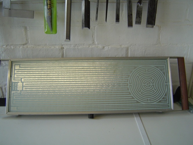

Michael, I always use HHG on braces now but I also find that it's beneficial when using it to keep the braces nice and warm before gluing them. Sometime ago I bought a Hostess tray, used to keep food warm, off eBAy, and it has proved to be the ideal tool. Lay all the braces on the tray at a gentle heat and leave for a while and the wood will warm right through and hold heat long enough to give a good gel time. I use a hair dryer to warm the top/back. This is the one I use.
